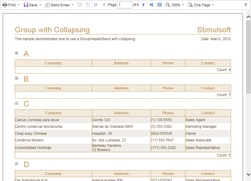

Collapsing is an opportunity to roll up and roll out, for example, groups directly in the rendered report. For example, if you have a report with groups, it usually displays the title of the group, and then the data by this group. In the case with collapsing the group title will be displayed and these groups can expand or collapse. Look closely at the picture below.
MVC Viewer

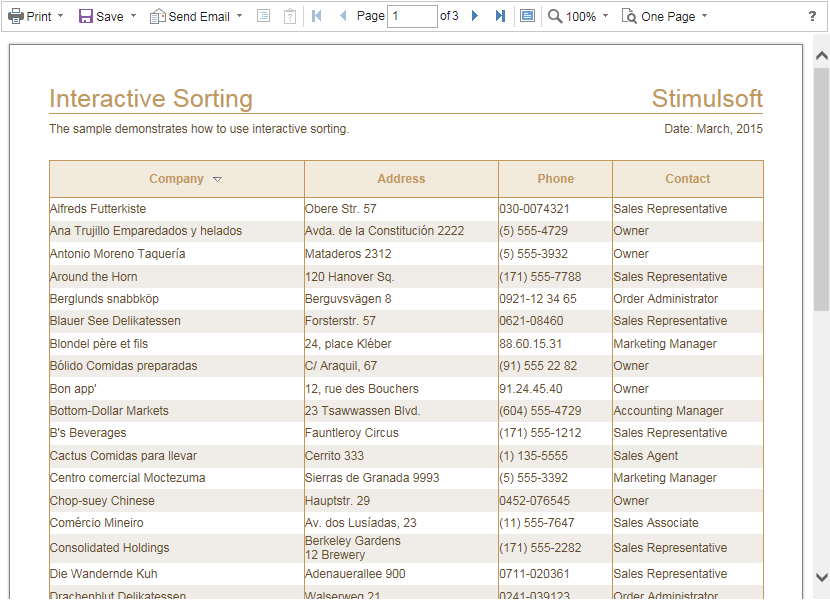

Interactive sorting means the ability to sort data in the rendered report. In other words, select the text component, assign a data column to it (by which sorting will be done) and render the report. When you click on this text component in the rendered report its content will be sorted. Each clicking on this component changes the sorting direction (ascending or descending order). It should be noted that the data column is used in the text component and the data column specified for the interactive sorting may vary. See an example below.
MVC Viewer

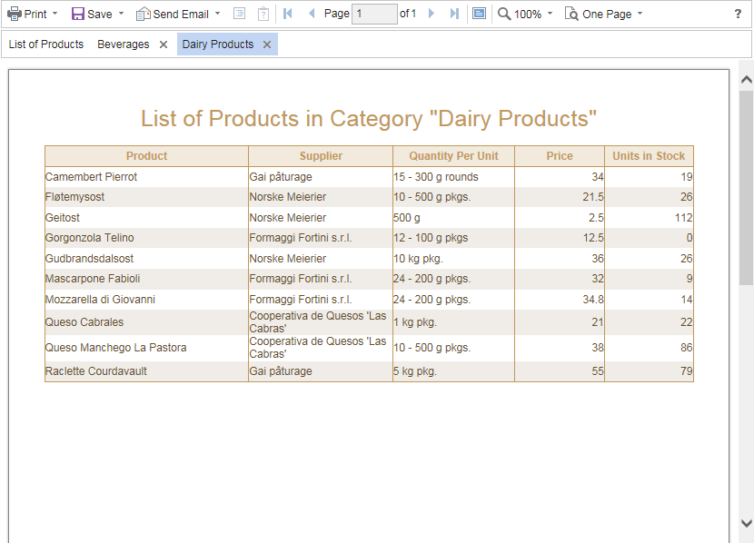

Drill down is a certain type of data connection. For example, there is a list of categories with descriptions and images. The drill-down reports have interactivity that is represented by showing the content when you click on any category (for example, a list of products). Below is an example of a drill down report.
MVC Viewer
