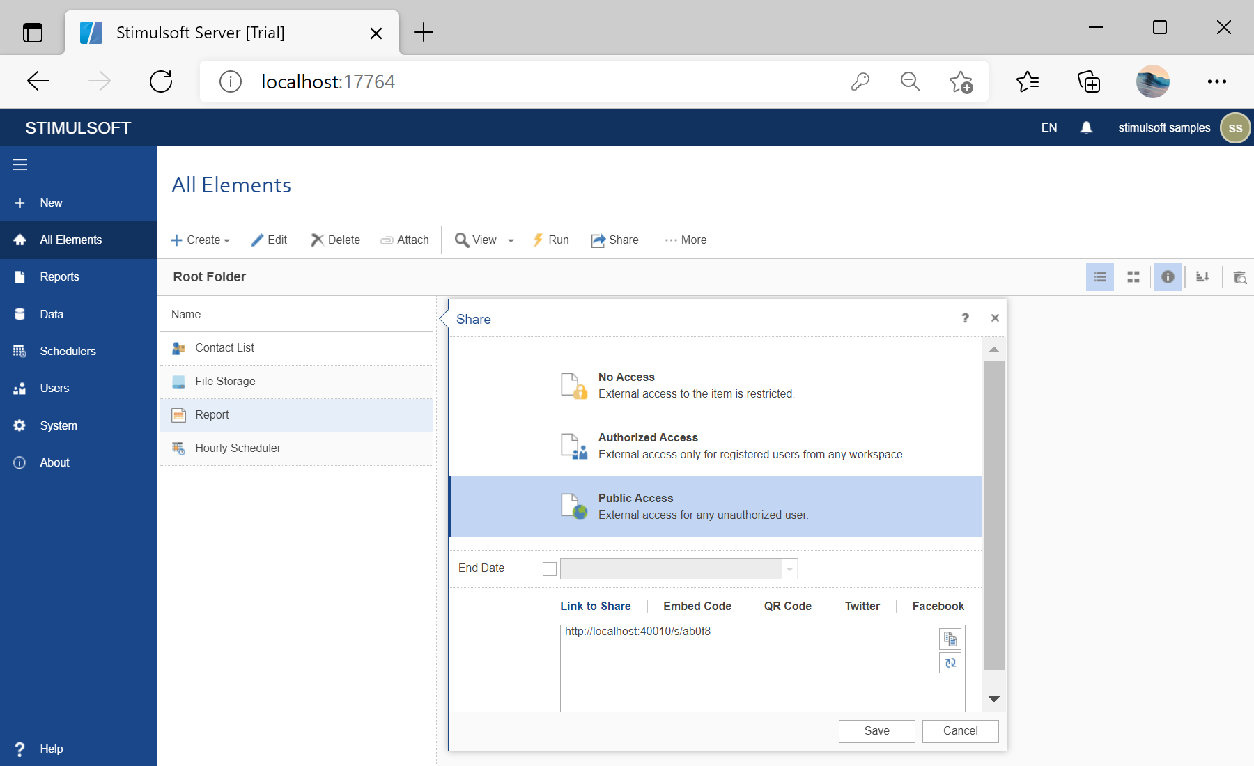

To share the report snapshot (or another item) you can use the share REST command of the items commands group. As parameters, you need to specify the share level and share expires date. These parameters can be passed as the request post data. Finally, you can get the shared item URL using the same command without parameters, you should specify only the shared item key in the REST command:
// Share snapshot
var req_shareItem = new XMLHttpRequest();
req_shareItem.open('PUT', 'http://localhost:40010/1/items/' + snapshotKey + '/share', false);
req_shareItem.setRequestHeader("x-sti-SessionKey", sessionKey);
var event = {'ShareLevel':'Public', 'ShareExpires': expiriesDate};
event = JSON.stringify(event);
req_shareItem.send(event);
// Get share url
var req_shareGetUrl = new XMLHttpRequest();
req_shareGetUrl.open('GET', 'http://localhost:40010/1/items/' + snapshotKey + '/share', false);
req_shareGetUrl.setRequestHeader("x-sti-SessionKey", sessionKey);
req_shareGetUrl.send();
var resultShareGetUrl = JSON.parse(req_shareGetUrl.responseText);
var url = resultShareGetUrl.ResultUrl
// open report by the share url
location.href = url;
}На скриншоте ниже Вы можете увидеть результат выполнения данного кода:
